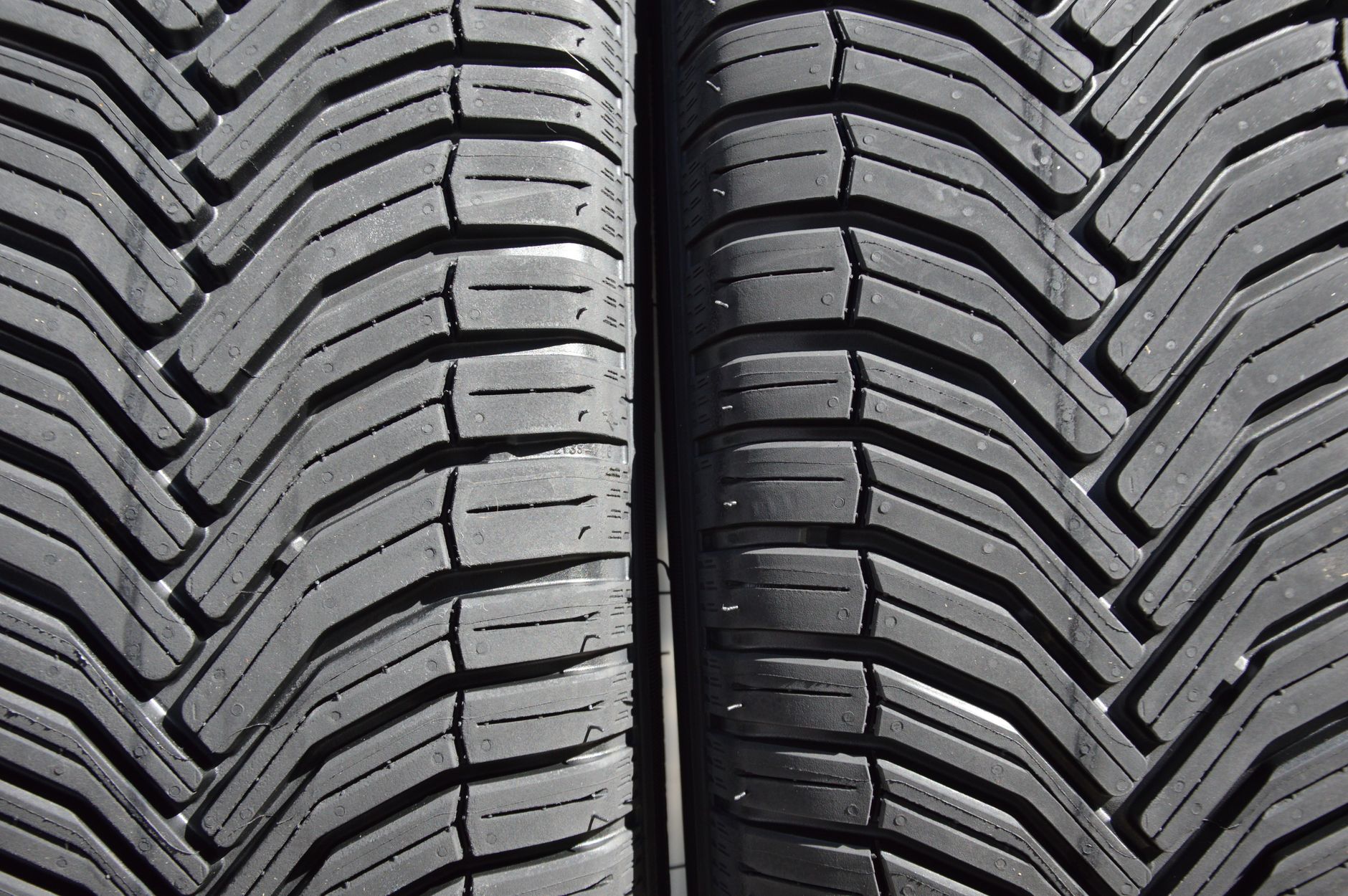

Close-up comparison of semi-slick track tyre versus road tyre tread pattern
Photo by Ulrick Trappschuh on Pexels
