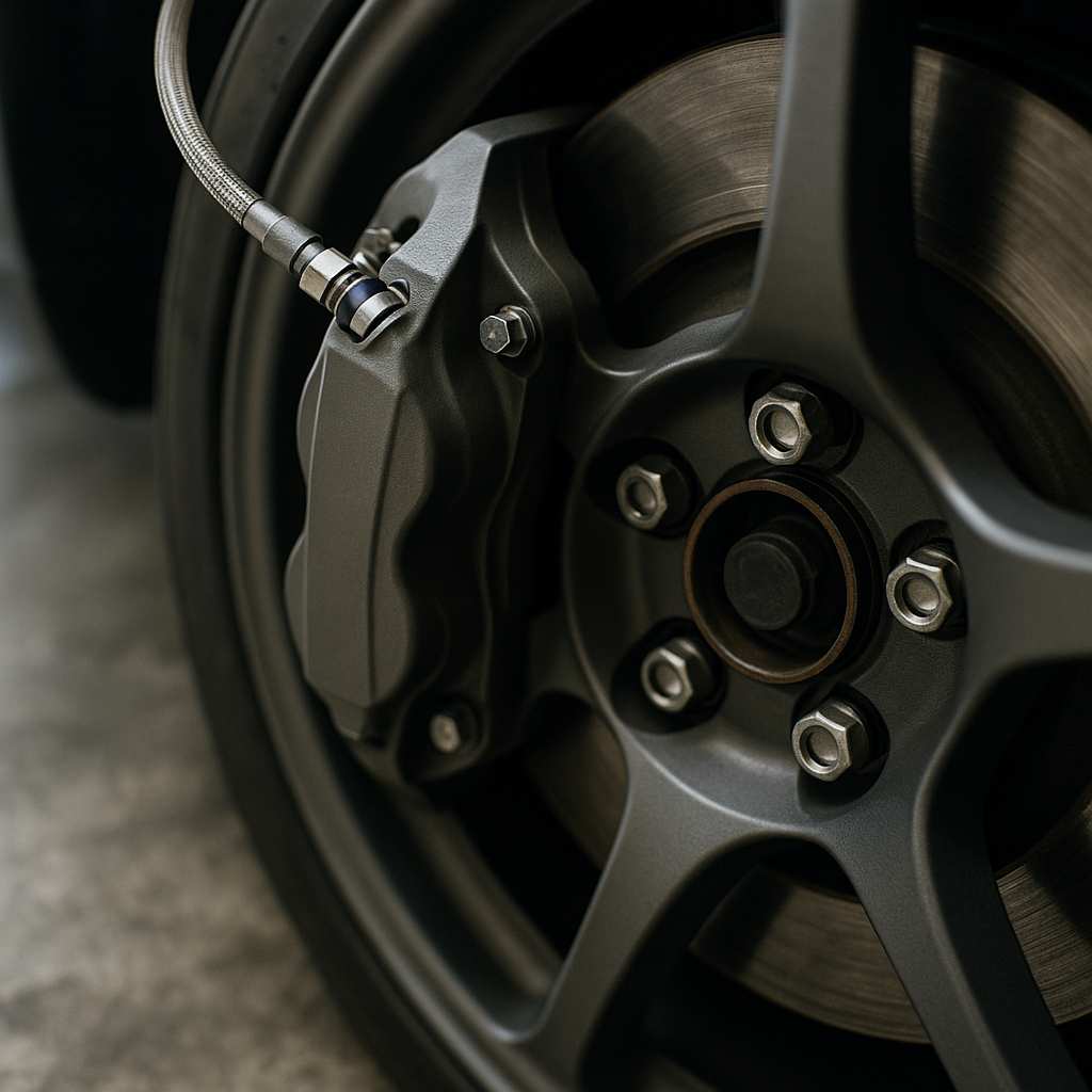

Braided brake lines and uprated calipers fitted during a budget track day car build

Brakes: The Non-Negotiable Starting Point
Standard road brake pads will fade to nothing on circuit. Uprated pads from Mintex, EBC, or Ferodo are available from around £50 to £100 per axle for most popular platforms. Braided brake lines are worth adding at around £80 to £120 for a full set. Switch to proper track or race-spec brake fluid, such as Motul RBF 660 or similar; your road-spec fluid will boil within three or four laps in high-ambient conditions. This is genuinely life-safety stuff, not enthusiast fluff.
