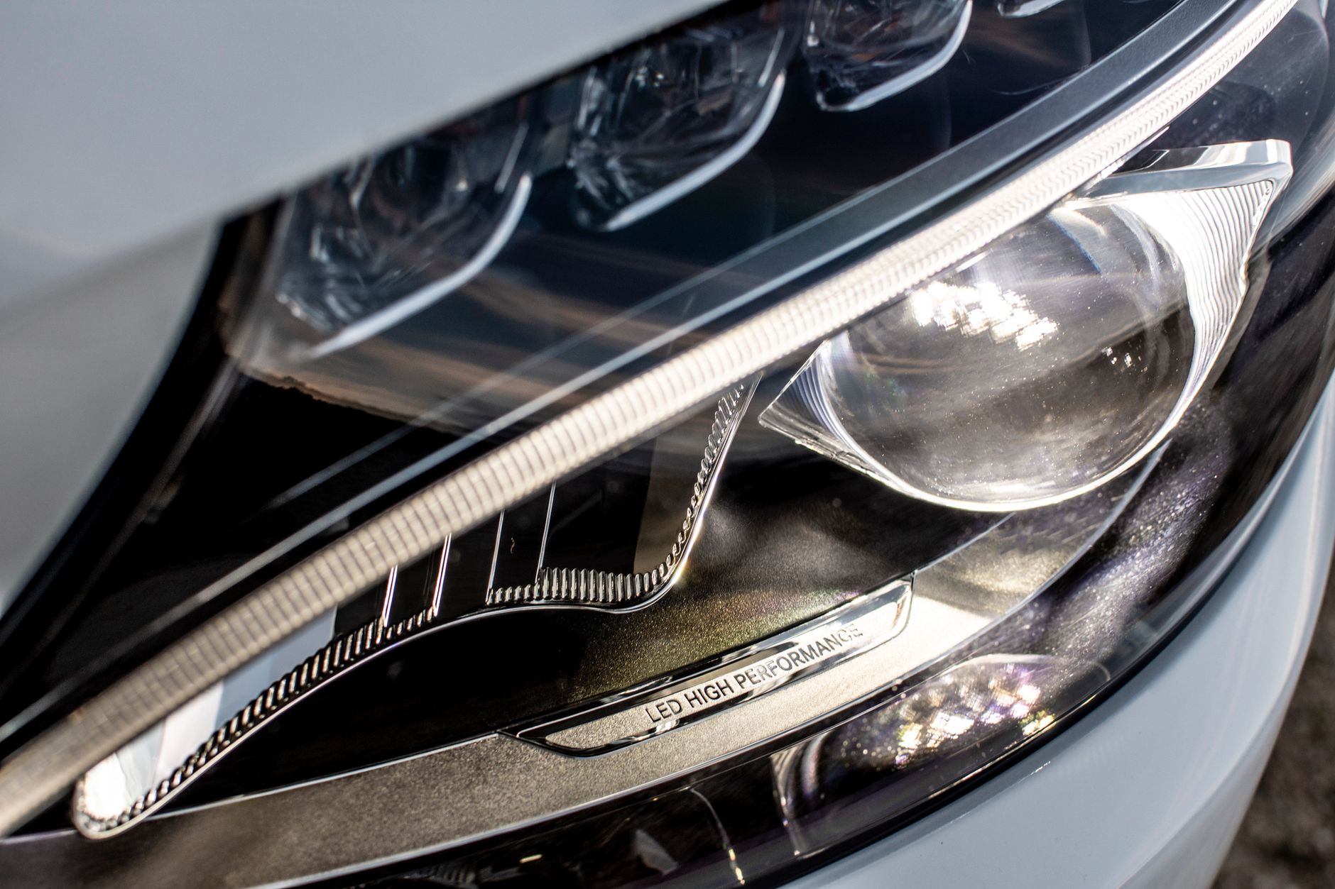

Aftermarket lighting is probably the single biggest area of modified car MOT failure UK 2026. The issues split into two camps: aftermarket LED or HID conversions in housings not designed for them, and cosmetic mods like smoked or tinted lenses that reduce output below the legal minimum.
LED bulbs retrofitted into halogen reflector housings are the classic trap. The beam pattern goes all over the place because the light source sits at a different focal point than the housing expects. Testers are now explicitly checking aim and scatter on these, and a good proportion are failing. If you’ve put LED bulbs into a standard halogen headlamp unit, you either need projector lenses designed for LEDs, or you go back to halogen. There’s no shortcut.
Smoked rear clusters, legal if they still pass the minimum light output threshold, but plenty of cheap aftermarket units don’t. Bring a cloth and clean them thoroughly before the test. Faded or stone-chipped covers can genuinely reduce output enough to fail. Also check your fog light. Aftermarket bumpers that delete or reposition the fog lamp are a fail if the replacement isn’t homologated.
