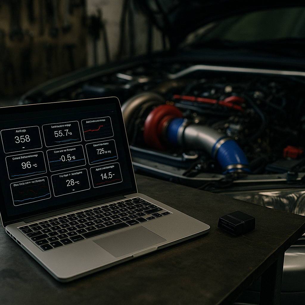

OBD-II Bluetooth dongle and laptop showing live engine data used to read OBD-II codes in a workshop

How to Actually Use a Scanner: Live Data Is Where the Real Information Lives
Reading and clearing fault codes is the beginner move. The real power in learning how to read OBD-II codes comes from live data streaming. Every decent scanner or app will show you real-time sensor readings while the engine runs, and this is where diagnostics becomes genuinely interesting.
Watch your short-term and long-term fuel trims. If short-term fuel trim (STFT) is regularly pulling more than plus or minus 10 percent, the engine is fighting to maintain stoichiometry. Pair that with a lean code and you have a clear direction to investigate. Watch your intake air temperature against coolant temperature at startup. Monitor O2 sensor switching frequency to judge converter health without a probe in sight.
A code tells you a symptom. Live data tells you the story behind it. The difference between a good home mechanic and a great one is usually just willingness to sit with the data a bit longer.
