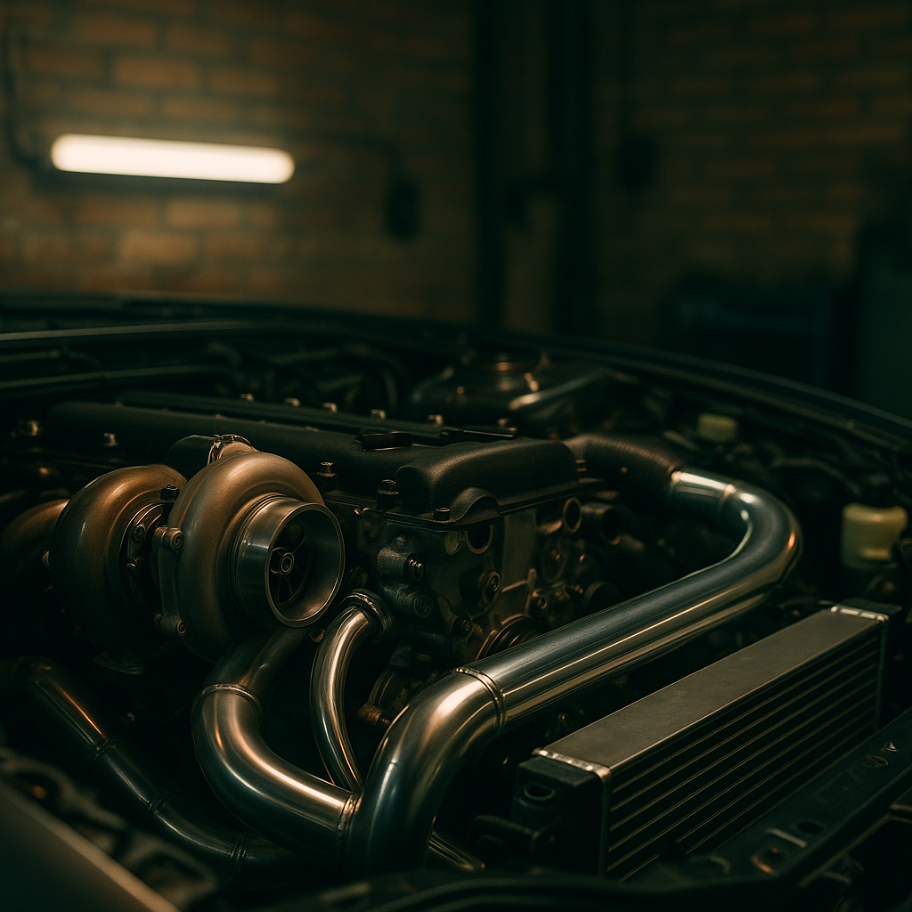

Turbocharged engine bay build showing turbo vs supercharger which is better for car builds

A turbocharger uses exhaust gases to spin a turbine, which in turn compresses incoming air. It’s essentially free energy recovery; you’re harvesting waste heat and pressure that would otherwise disappear out of the back of the car. The downside is that turbos take a moment to spool up, particularly on larger setups, which is where the infamous turbo lag comes from.

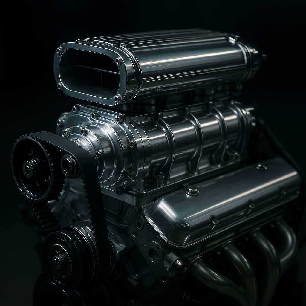

This is where things get subjective but important. A supercharger gives you linear, predictable power from low revs. Plant your foot and it responds immediately. It feels muscular and torquey, which is why you still see positive displacement blowers strapped to V8 muscle cars and big American-influenced builds over here.
A turbo, especially a modern twin-scroll or variable geometry unit, can feel completely different. On a well-set-up build with the right sizing, the spool is barely noticeable and the top-end surge is genuinely violent. Some builders chase that hit deliberately; it’s part of the character. For track work specifically, experienced drivers learn to manage boost onset and use it to their advantage. Beginners sometimes find it more difficult to exploit cleanly.

Supercharger close-up detail relevant to turbo vs supercharger which is better debate
