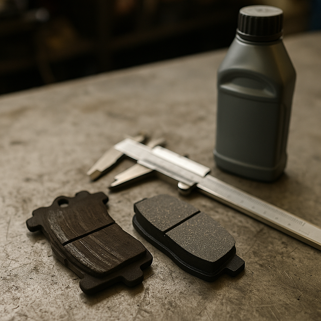

Check your wheel bearings by lifting each corner and shaking the wheel at 12 and 6 o’clock. Any play whatsoever is a no. Inspect your brake pads and discs too. Most track day organisers will do a basic scrutineering check, but they are not going to strip your callipers. That responsibility sits with you. If pads are below 5mm, replace them before you go. Budget around £60-£120 for a decent set of upgraded pads from brands like EBC or Mintex.

Road cars are built to brake repeatedly at relatively low intensity. On track, you are asking for hard, sustained braking from high speed into tight corners, lap after lap. The two failure modes to understand are brake fade (overheated fluid boiling in the callipers) and glazed pads (overly gentle braking that never gets the pads up to working temperature, which is actually more common with beginners).
Upgrading your brake fluid to a proper motorsport-spec fluid with a higher dry boiling point is cheap insurance. Castrol SRF or Motul RBF 660 are both available for under £25 a litre from most performance suppliers. Bleed the system properly the week before the event. If you have the budget for upgraded pads, look at EBC Yellowstuff or Ferodo DS Performance compounds, both of which work acceptably on road and light track use. Do not put full racing compounds on a road car and expect them to work cold on the way home. They will not.
