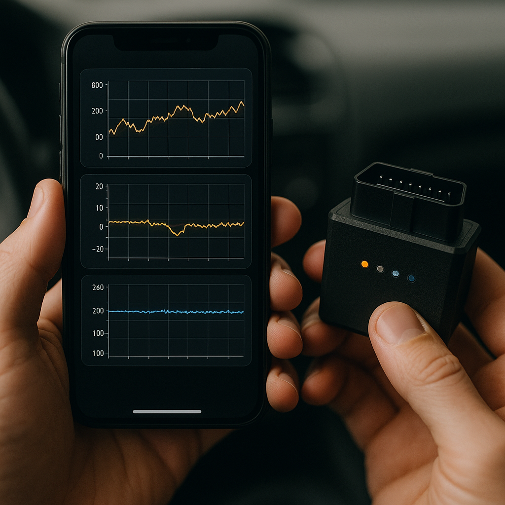

OBD-II (On-Board Diagnostics, second generation) is a standardised protocol fitted to all petrol cars sold in the UK from 1996 and diesels from 2004. It gives external devices access to the ECU’s live data stream via a 16-pin port, usually found under the dashboard on the driver’s side. A data logger plugs into this port and records parameters, known as PIDs (Parameter IDs), in real time. These can include coolant temperature, MAF readings, fuel trims, RPM, and vehicle speed among dozens of others depending on the car.
Budget Bluetooth dongles like the ELM327 clone variants pair with a smartphone app and give you read/clear fault codes plus basic live data. Step up to dedicated hardware like the OBDLink MX+, Veepeak OBDCheck, or Alientech K-TAG interface tools, and you’re into proper multi-channel logging territory with far more reliable polling rates. For serious tuning and data analysis, standalone loggers like the AiM Solo 2 DL or a Haltech logging module bypass OBD-II entirely and tap directly into the ECU, giving you millisecond-level resolution that phone apps simply can’t match.

The hardware you need depends entirely on what you’re trying to achieve. For fault diagnosis on a daily driver, a reliable Bluetooth or Wi-Fi OBD-II adapter paired with an app like Torque Pro, OBD Fusion, or Car Scanner ELM OBD2 is perfectly adequate. These apps let you customise dashboards, log data to CSV, and read both generic and manufacturer-specific codes on most mainstream platforms.

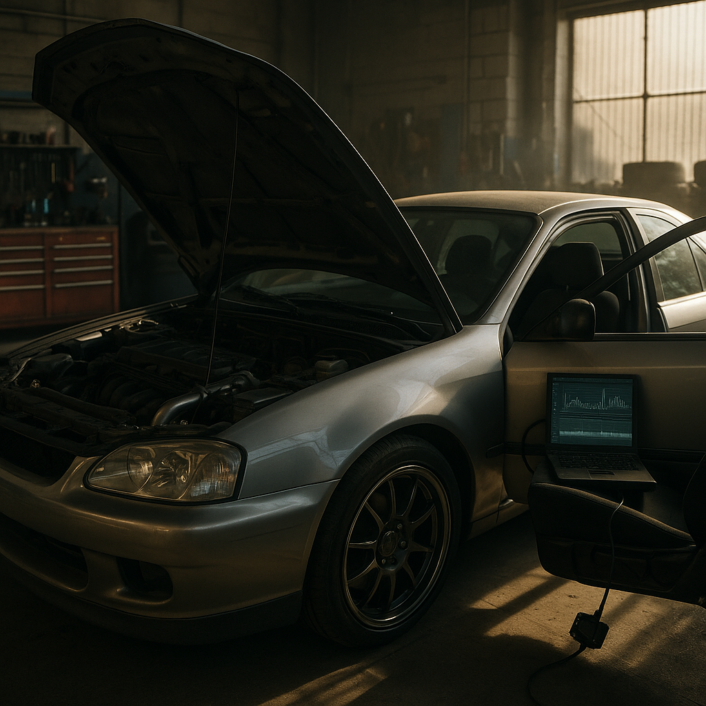

Setting Up Your First Data Logging Session
Before you even turn the key, decide what you want to measure. Logging every available PID simultaneously sounds thorough, but it actually degrades the polling rate and makes your data muddy. A focused log of six to eight PIDs is far more useful than a wall of noise. For a general health check, start with: engine RPM, coolant temperature, intake air temperature, throttle position, short-term and long-term fuel trims, and MAF sensor reading.
Connect your adapter with the ignition off, then start the engine and let it reach operating temperature before beginning your log. If you’re testing performance, you want a warm engine making consistent numbers. Drive a repeatable route, including a full-throttle pull in second or third gear if safe and legal to do so, then return to base and pull the log file. Most apps export to CSV which you can then open in Excel or dedicated analysis software like MegaLogViewer HD.
